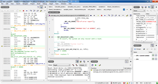

    Now, when I send the program on the devkit, it does not advertise. When I debug, it gets stuck in the app_error_weak.c file where the NRF_BREAKPOINT_COND placed, as you can see in the image below.
    I searched the error code, but I did not find anything.
    Could you please guide me?

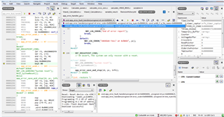

  • What is calling the error handler? How far does the program reach before it enters the error handler? Try setting a couple of breakpoints and see if the program reaches it.

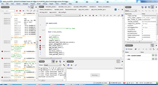

    Here is my main function:

    I set a breakpoint point for every function. Once it reached the log_init, the program got stuck in the error.
    I also comment out the log_init() function, then I debug the program. In this case, the program stays in the ble_stack_init() as you can see below.
    I have no idea about this.
    What do you think?
    Please guide me.
