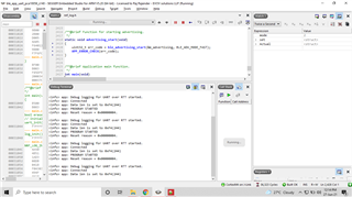

  • There are couple of NVIC_SystemReset() added into your main.c file. They are the reason for the resets on your device. Look at the snapshot of the debugging window that i started using your project.
    Why did you add those resets?
