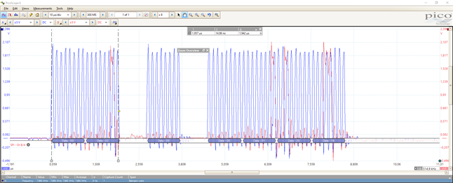

    I am using the default config (NRF_DRV_QSPI_DEFAULT_CONFIG) just as the example does. When I trace this to the config actually used in the nrfx_qspi_init function I do see that he is using NRF_QSPI_FREQ_32MDIV4. This explains the 8MHz, but it does seem that the code completely ignores the sdk_config setting. Also why is the value in the NRF_DRV_QSPI_DEFAULT_CONFIG not the same as the default value in the sdk_config?
    I checked with both a logic analyzer and scope. The logic analyzer is an older Saleae model and seems to have some trouble with the 8MHz. Here is a screenshot of the trace, taken by the scope, of the clock and the MISO line, in this particular trace you can see the chip idea being read.
    It seems like the values used in the NRF_DRV_QSPI_DEFAULT_CONFIG lead to a file called apply_old_config and this file is all greyed out.
    Michiel
