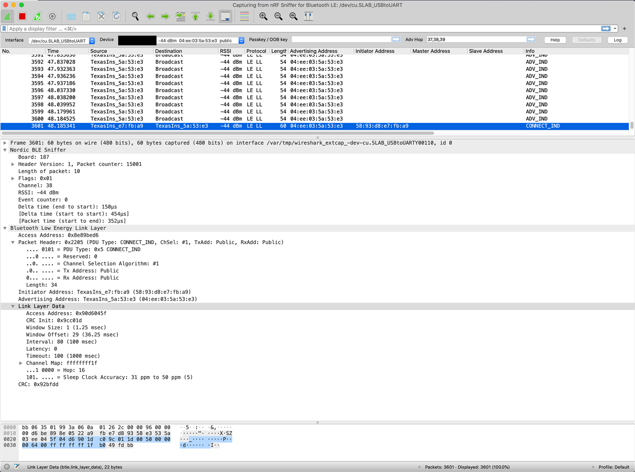

Wireshark BLE Sniffer is not showing any packets during or after Peripheral connect
I start the sniff and see packets from all advertising peripherals in the area.
I select my peripheral in the Device dropdown list.
Then I see a string of "ADV_IND" packets from my device only.
I have no Capture or Display filter active.
All well and good.
Then I enable my Central device and start the connect.
-> They connect without any trouble and start streaming data.
However all I see in Wireshark is a single "CONNECT_IND" packet. Nothing else.
--> I don't see any other packets!
Does anyone have any guesses as to what I'm doing wrong?
Driver/firmware/software versions perhaps?

  • Hi Simon,
    Thank you for your reply. The screenshot you requested is below. Well, it will be after I figure out how to post it. But moving on ...
    I have in fact updated with the latest J-Link Software Pack, but it's not clear how the UART drivers are installed/called in my setup because my "nRF51822 v2" came preprogrammed. Are you saying I should try to overwrite my preprogrammed nRF51822 v2 that I received 2 weeks ago? Or is there some other (of the 11 installed J-link apps in the Software Pack) that I should install/run?
  • No Packets are received (displayed) after the CONNECT_IND.

  • Okay, according to the Adafruit BLE sniffer introduction, the Adafruit device is at a mismatch with version 3.1.0 of the Sniffer firmware you've installed on Wireshark, and they only provide support for v2.0.0 (Beta version actually) of the sniffer firmware. You can either download the Wireshark extcap.zip (BETA 1) from their user guide, or from the nRF Sniffer product page on our homepage.
    Simon
