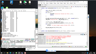

    all other not changed,but build\debug\go ,the board always reset,can not run, ,ble app cannot connect board ,is there other place need to be modified in program,

    You have some issues in your code, and I suspect you did not configure the stack on the network core. The following quick and dirty changes to the peripheral_uart sample does what you want and I tested to verify that the data length is updated to 80 upon establishing the connection:
