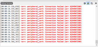

Hi Markus,
I have got the error code 4294967280.
Thanks & Regards
Navin
And which function in your application does return this error code?
Hi markus,
While writing with the "I2C_write" function returns that error.

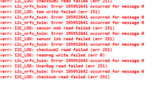

HI Markus
I am debugging my code by giving logging conditions. I have got the below error
Then, I have tried with a Logical analyzer. I can write on a device. But I can't able to properly read

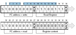

According to the datasheet. I am trying to read the user register as like as mentioned below.
By seeing the Logic analyzer out. I understood, I can't able to set the device to read.
I had written the below function for reading. After, seen my requirements and my code. Kindly suggest me a way
u8t SHT2X_ReadByte(u8t reg_addr)
u8t array[I2C_BUFFER_LEN] = { 1 };
array[0] = reg_addr;
int cnt = 1;
error = i2c_write_read(i2c_dev,SHT2x_DEV_ADR,&array[0],1, &array[0], cnt);
return error;
I have called this function like this.
SHT2X_ReadByte (I2C_ADR_R);
