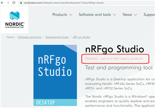

  • nRFgo Studio
    nRF GO Studio is ancient - does it even support nRF52832 ?
    You should be using nRF Connect:
    further down that page:
    Or just download direct from SES.
