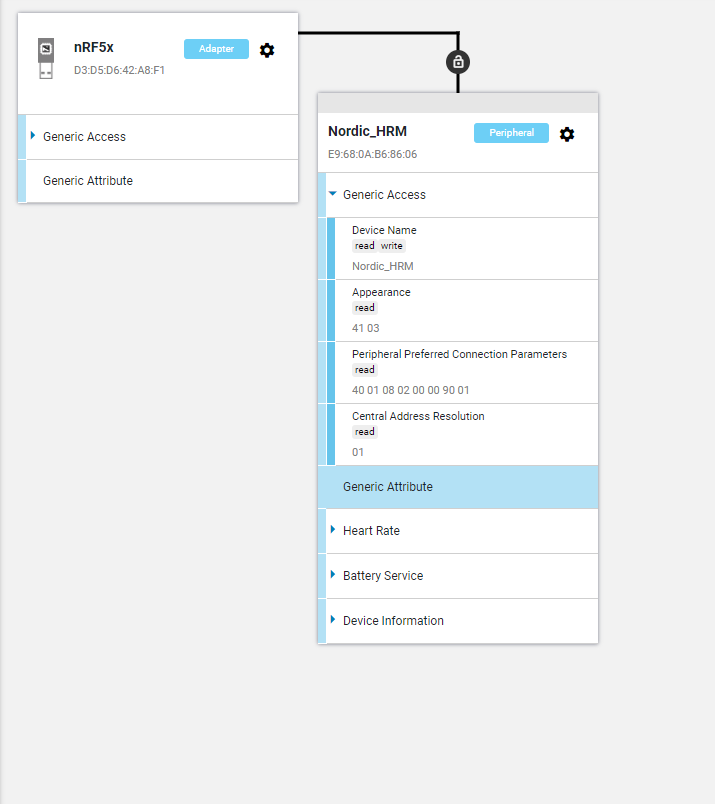

    1. I would like to understand which services that are not explicitly defined are being communicated by the Softdevice (for example - I see a service 0x2902 which I don't see anywhere in my code.

    If you want to know what's 0x2902 is you can have a look at the list here (16-bit UUID Numbers)
    It can be the CCCD for the service changed characteristic.
  • Hung,
    The nrf52840 is the peripheral and server. The phone (using Web bluetooth) writes the 0x2902 upon connection and before disconnecting. I haven't defined explicitly this service. I wonder which services are implicitly defined by the Softdevice.
    Daniel
  • Please provide the service UUID (0x2902 is only the UUID of the CCCD, not the service UUID).
    If you don't want to send the sniffer trace, you can use nRF Connect app on PC and do a service discovery of the attribute table, something like this:
    If you want you can convert this case to private (GO PRIVATE) if you have confidential information.
