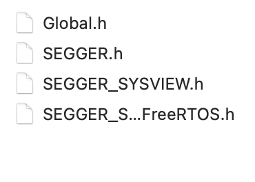

It looks to me that the project settings (preprocessing include paths) are not set to point to the directory where this segger_sysview files are located. Can you post your project include paths here and the location where you SEGGER_SYSVIEW_FreeRTOS.h file is located ?
Else you can give me your project so that i can quickly do a smoke test on my desk and see what is missing.
In the preprocessor list, I've got "SystemView", which is the folder in the root project directory containing the following files.
