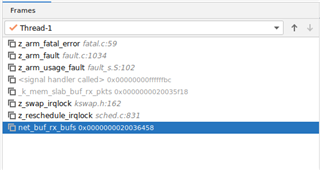

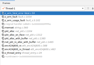

    If you debug the secure image (spm/zephyr/zephyr.elf) and break on the hardfault handler (or other fault handlers, like z_arm_fatal_error())
    I set a breakpoint in z_arm_fatal_error(). Then when the error occurred I got the following call stack:
    The other time I tried it I got the following callstack:
    --> here I noticed that the buffer that is generated in pkt_alloc has an address of 0x2b083 which seems to be invalid.

  • Hi Michael,
    Those stack traces and faults seems to match better.
    The fault is now a MPU-fault (ie: a alloc is asking for more RAM than it has), and it seems that you have already found a suspect in the net-bufs. I agree with your findings, both call stacks point to the NET stack slab memory on both scenarios:
    https://github.com/nrfconnect/sdk-zephyr/blob/master/subsys/net/ip/net_pkt.c#L112-L113 (expands to _k_mem_slab_buf_rx_pkts)
    Adjusting the NET_BUF_*X_COUNT should fix these two faults, but I think you're on the right track to also keep an eye on the stack size as well.
