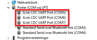

I have seen this question asked a few times--but every thread seems to have no concrete answer.
I have uninstalled and reinstalled all JLINK drivers.
But still get the errors.
I have nrf52840 dk and am using windows 10

In your Device Manager, is there a JLink UART Port visible (similar to as shown in the picture below, which is from the nRF9160 that has 3 JLink UART ports)?

Markus,
When connected, only one of the 3 shows up:
Hello Christian,
christian11 said:When connected, only one of the 3 shows up:
Yes, that would be correct.
