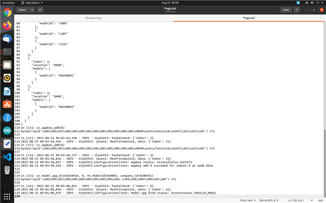

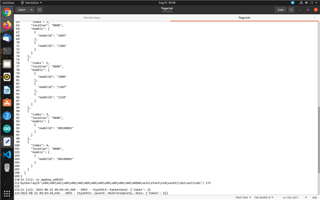

    Can anyone suggest me that why i am getting "Invalid model" while I am binding  "Vendor Model".
    Here is the composition data received from the device when i am requesting it.
    In [10]: cc.composition_data_get()
    bytearray(b'\x08\x00\x01\x00\x00\x00\x08\x00\x00\x00\x80\x08\x00') 171

    2022-08-25 09:03:28,471 - INFO - ttyACM13.ConfigurationClient: Received composition data (page 0x00): {
      "cid": "0059",
      "pid": "0000",
      "vid": "0000",
      "crpl": 40,
      "features": {
        "relay": 0,
        "proxy": 0,
        "friend": 2,
        "low_power": 2
      "elements": [
          "index": 0,
          "location": "0000",
          "models": [
              "modelId": "0000"
              "modelId": "0002"
              "modelId": "1004"
              "modelId": "1000"
              "modelId": "1006"
              "modelId": "1007"
              "modelId": "1002"
              "modelId": "1300"
              "modelId": "1301"
              "modelId": "1303"
              "modelId": "1304"
              "modelId": "1203"
              "modelId": "1204"
          "index": 1,
          "location": "0000",
          "models": [
              "modelId": "1002"
              "modelId": "1306"
          "index": 2,
          "location": "0000",
          "models": [
              "modelId": "1000"
              "modelId": "130f"
              "modelId": "1310"
          "index": 3,
          "location": "0000",
          "models": [
              "modelId": "00590001"
          "index": 4,
          "location": "0000",
          "models": [
              "modelId": "00590002"
  • I also tried the exact method as you did to bind the vendor model but I am getting Invalid model during binding
