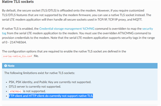

  • Thank you for your reply Markus.
    Some more questions:
    Looking at the paragraph on Native TLS Sockets, it states that HTTP Client is not supported.
    Does that mean that HTTPS GET and POST not be supported if I use TLS Sockets?
    Regarding "We are continuously working on improving our products.", and since it will require a HW change to support TLS fragments > 2KB, is there a known plan to update the nRF9160 HW in that respect?
    Regarding "content-range", will it also work when sending data > 2KB?

  • Hello Koby,
    The Serial LTE modem application does not come with native TLS support for FTP and HTTP. But it is possible to add it to this or any other application.
    As a reference, you can have a look at this example. The commit adds native TLS support to TCP proxy command within the Serial LTE modem application. Hence, similar changes could be made for HTTP commands to add native TLS support or the host could run the HTTP stack and the client can manually send HTTP via the TCP commands.
