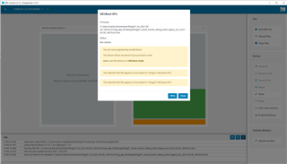

    • Since the debug image does not support MCUboot DFU, see picture below:

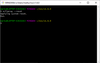

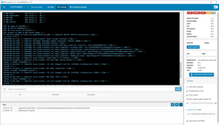

    • In LTE Link Monitor, i unchecked “Automatic requests”.
    • Then I rebooted my Thingy:91 via this terminal command:
    • And got the output shown below (connection attempt fails on my Thingy:91 since SIM card does not support NB-IoT.)
    Markus
