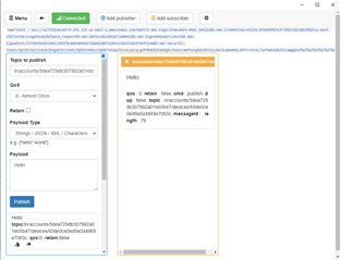

    I know that the Broker Url and Client_id works because I'm using MQTTBox client and I can connect to the broker using the same certificate file that I uploaded to the modem.
    As you can see in the following image the MQTT Box Mqtt client is connected to the broker using websockets secure.
