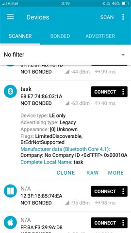

I am able to set the manufacturer data with values of lis3dh in advertising mode. I am abel to get values
0x00010A this is the lis3dh data but i want that these acceleration values should be displayed in floating format
