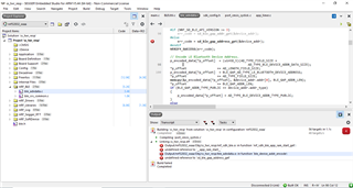

I copied the main file source code from the ble_app_beacon example from nrf SDK to a new file in ss_twr_resp example to integrate BLE with UWB and give a demonstration (I haven't advanced to the scanning yet just trying to get BLE and UWB working together). I added all necessary files through SEGGER using "add existing file". Furthermore, for every file I added, I also went to the options of the project, into preprocessor, and added the folder path to "User included Directories". When I build the project, I get the following:
Mainly, I see two errors. Error 1 indicates there are two definitions of specific functions. I'm quite sure I did not define them twice. However, I don't know how to approach this problem.
Error 2 indicates undefined references, which are functions that cannot be found. Although I included the necessary file in SEGGER through "add existing file", and preprocessing, I still get this error (for instance app_timer.h is added, but app_timer_init() still is undefined, according to SEGGER). This is how I solved the same other errors I was getting, but these ones seem to persist.
Can anyone help me with this issue, please? I'd appreciate any comments or suggestions. Let me know if you need any other information. I hope my question was clear.
  • I did that. It seems that the xPort error was converted into multiple definitions. However, I deleted the function xPortSysTickHandler from freertos to resolve it. Thankfully, no additional errors were produced, but I don't know if that's the correct way.
    I attempted to follow the same method with "undefined reference to `__app_ram_start__'". However, __app_ram_start__ is defined in several files and seems to be already declared. So, I'm not sure there is an undefined reference error.
    For the sd_ble_gap_address_get error that happens in ble_advdata.c, it's a function that's in ble_gap.h. However, ble_gap.c does not exist in the project after I did a search with control-f you recommended. My current errors are:
    And my current project is:
