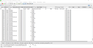

Setting the child image as hr_coded for be available to work on coded. This is my output, so i think that is working but i am not sure:

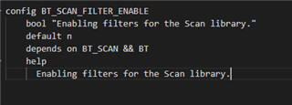

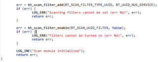

I need to make the scan only on coded_phy, for that i set up the next:
But unfortunately both devices don´t connect, and when i debug central it seem is crashing:
I think maybe i missed something on Kconfig of board... but i don´t know.
My way to implement is correct? There are a better and cleaner way to do it? My parameters of setup for scan and conn have sense?
