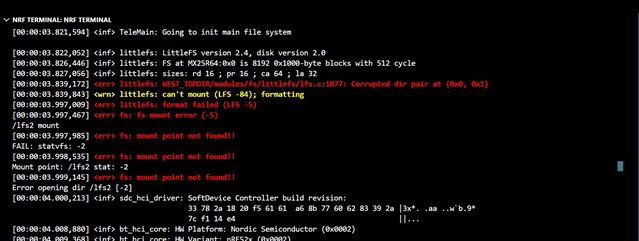

    I've had trouble finding any detailed documentation on the structure/internals of littleFS.    But I've traced through the code and the error appears to occur when the CRCs are being checked during the formatting process.     I saw one post that implied that the config statement "CONFIG_APP_WIPE_STORAGE=y" should be included in prj.conf, but if I do so, the build process fails, indicating that this configuration variable was not found.
    I assume the physical interface to the chip works since it reads the jedec-id (I had to change the listed on in the .dts file to expect the one in the S25FL device.).    As I mentioned earlier, I had the software running on the -DK board, but am struggling to get it working on my custom board with a different (larger) QSPI device.

    Can you upload the overlay (.dts) file where your QSPI (pins, size, etc.) are set up of how it looks now so we can take a look? I'm afraid I'm not familiar with an error in this line in lfs.c, but it seems like the dir pair is corrupted at some point when trying to fetch a matching dir...
    Simon

    Note that I started with the nRF52840-DK file and edited it to reflect my board.    Also, I have two file systems.   "/lfs1" mounts the on-chip storage partition, while "/lfs2" is for the external flash device attached to the QSPI bus.      Also note that I didn't change the "name" of the flash device, but rather changed the important parameters.

    From this .dts file it seems like the QSPI is defined as the MX25 flash chip that is onboard the nRF52840. You need to configure it for the S25FL that you're using. Make sure that the size and write/read permissions fits that board.
    Simon
