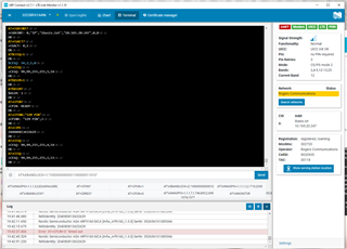

  • Hi Haken,
    After many tests I am still unable to connect to any band other than Band 12.
    Band 12 connects right away but other bands just do not work.
    I tried on Thingy91 with AT Client example and At LInk Monitor.
    I have tried using BandLock command and it is working as I can see the Bands update on the GUI as well as when I send out AT%XBANDLOCK?
    I have tried manually sending the MAGPIO command to set different different band settings as well but all without success.
    At this point, I can safely say that the device just won't connect to any Bands other than 12.

    Are you sure that LTE M (or NB1) is available on other bands in your area?
    Do you get connected on other bands with a nRF9160-DK/thingy91 for instance?
    If you lock the bands to the other band, then do a manual search using AT+COPS=? it should return any network it finds. If it does not find any, it's highly likely not available in your area.
