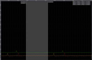

    The below graph shows the problem on as measured with the nrf52dk
    Green is with is using i2c (with nothing physicall connected to dk) and an edge trigger
    Red is with using i2c (again nothing connected) and a level_low trigger
    Yellow is with the edge trigger and no i2c

    It took a while and some discussion with my colleagues, but it seems like we've gotten to the bottom of it. There seems to be some strange bug wherethe I2C driver doesn't handle the errata 89 workaround after your accReadRegister() function when the GPIO edge trigger is set. When reproducing this, we saw that commenting out the accReadRegister() function from the main loop also put the current consumption back to normal, and implementing the errata 89 workaround after the accReadRegister() function put the device back down to ~20uA. I have reported this bug internally, so the developers will take a look at it and fix this for a future release of the NCS.
    So the workaround here will be to, immediately after the accReadRegister() function in your application, add a short "wait" before implementing the errata 89 workaround manually.
    Simon
  • According to our developers, this issue should also be fixed in NCS v1.6.0, where a new config option is available for the nRF GPIO driver in Zephyr. It allows avoiding the use of GPIOTE for generation of the edge triggered interrupts, please see GPIO_NRF_INT_EDGE_USING_SENSE for details. Using this option should help keep the current consumption low in your case.
