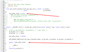

I made same code for SDK15 and it works. Now I want to rebuild project on the new SDK17.0.2 and same part of code doesn't work with SPI master.
For notice- doesn't work native example
...examples\peripheral\spi\
And I made on the my project all settings like it was on SDK15 and can't call interrupt spi_event_handler.
my settings:
#define SPI_INSTANCE  0 /**< SPI instance index. */
static const nrf_drv_spi_t spi = NRF_DRV_SPI_INSTANCE(SPI_INSTANCE);  /**< SPI instance. */
static volatile bool spi_xfer_done;  /**< Flag used to indicate that SPI instance completed the transfer. */
void spi_event_handler(nrf_drv_spi_evt_t const * p_event,
                       void *                    p_context)
    spi_xfer_done = true;
//    NRF_LOG_INFO("Transfer completed.");
    if (m_rx_buf[0] != 0)
        NRF_LOG_INFO(" Received:");
//        NRF_LOG_HEXDUMP_INFO(m_rx_buf, strlen((const char *)m_rx_buf));
static __INLINE uint8_t lis3dh_spi_read_write(const uint8_t reg, const uint8_t data)
//	uint8_t rx_buffer[2], tx_buffer[] = { reg, data };
    m_tx_buf [0] = reg;
    m_tx_buf [1] = data;
    spi_xfer_done = false;
    APP_ERROR_CHECK(nrf_drv_spi_transfer(&spi, m_tx_buf, m_length, m_rx_buf, m_length));
    while (!spi_xfer_done)
        __WFE();
	return m_rx_buf[1];
uint8_t lis3dh_read(const uint8_t reg)
	return lis3dh_spi_read_write(reg | LIS3DH_READ_MSK, 0xAA);
void lis3dh_write(const uint8_t reg, const uint8_t data)
	lis3dh_spi_read_write(reg | LIS3DH_WRITE_MSK, data);
void lis3dh_init(void)
    spi_config.ss_pin   = 7;
    spi_config.miso_pin = 8;
    spi_config.mosi_pin = 9;
    spi_config.sck_pin  = 10;
    APP_ERROR_CHECK(nrf_drv_spi_init(&spi, &spi_config, spi_event_handler, NULL));
	lis3dh_write(CTRL_REG1, 0x2F);
What I make wrong?

    I don't see next call back:
    and when I run my code, lis3dh_spi_read_write function waits this flag.
    I notice, same code on the SDK15 works.

    1. I use #define SPI_INSTANCE  0 /**< SPI instance index. */
    2. Keil
    3. SPI event handler same for both projects on the SDK 15 and 17. And same settings and code.
