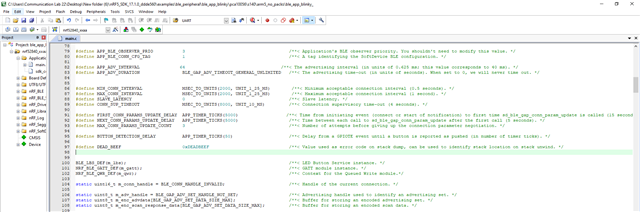

    #define MIN_CONN_INTERVAL MSEC_TO_UNITS(3000, UNIT_1_25_MS)
    #define MAX_CONN_INTERVAL MSEC_TO_UNITS(3000, UNIT_1_25_MS)

    If you make sure to add DEBUG in your preprocessor defines, like shown in the included image, the logger will output a detailed error message whenever a non-NRF_SUCCESS error code is passed to an APP_ERROR_CHECK.

    in nordic blinky code nrf sdk v17 s132 on dev kit nrf52832 ideally:
    #define MIN_CONN_INTERVAL MSEC_TO_UNITS(7.5, UNIT_1_25_MS) /**< Minimum acceptable connection interval (0.5 seconds). */
    #define MAX_CONN_INTERVAL MSEC_TO_UNITS(100, UNIT_1_25_MS) /**< Maximum acceptable connection interval (1 second). */
    then the code runs and flashes adv name with led blinking.

    But the max range of Connection interval from ble specs is 7.5 to 4000ms.
    so, when i set
    #define MIN_CONN_INTERVAL MSEC_TO_UNITS(2000 or 3000 or 4000, UNIT_1_25_MS) /**< Minimum acceptable connection interval (0.5 seconds). */
    #define MAX_CONN_INTERVAL MSEC_TO_UNITS(2000 or 3000 or 4000, UNIT_1_25_MS) /**< Maximum acceptable connection interval (1 second). */
     the device doesnt advertise anything??
    I just tried this with the Blinky example on my end, and it works as expected.
    Could you confirm for me whether you are updating your connection supervision timeout in accordance with these new connection interval parameters?
    The supervision timeout must uphold the conn_sup_timeout * 4 > (1+ slave_latency)*max_conn_interval constraint.
    If this is not upheld you will get an NRF_ERROR_INVALID_PARAMS or similar. In your case, that means that a 2000 ms interval will need more than 8000 ms supervision timeout, with a slave latency of 0.
    Though, if this was the case I would expect the program counter to go to the APP_BREAKPOINT_COND unexpectedly, so if you are not seeing this happening that might be something to look into.
     @note  If both conn_sup_timeout and max_conn_interval are specified, then the following constraint applies:
            conn_sup_timeout * 4 > (1 + slave_latency) * max_conn_interval
            that corresponds to the following Bluetooth Spec requirement:
            The Supervision_Timeout in milliseconds shall be larger than
            (1 + Conn_Latency) * Conn_Interval_Max * 2, where Conn_Interval_Max is given in milliseconds.
    This is an exempt from the ble_gap_conn_params_t documentation.

  • i have set max min Connection interval as 2000 and supervision tiemout as 8000ms. This in blinky code worked. But when i am setting max min CI as 4000ms it is not working.
    Also, i am not getting what is this connection supervision timeout.
