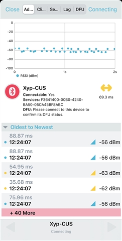

    Okay, so ALL i'm trying to do is: create a custom BLE service, and add read/write characteristics to read/send the attribute values. PREVIOUSLY, I have been able to connect to the BLE profile via nRF Connect phone app, but lately i have been seeing issues with nRF Connect app showing it's not CONNECTED, despite the ble_evt_handler getting invoked with a BLE_GAP_EVT_CONNECTED parameter passed in.
    I even tried the existing samples from the SDK including the ble_nus app, and it behaves the same way: nRF app doesn't show it's connected/i don't see any profiles but the ble_evt_handler does get passed with BLE_GAP_EVT_CONNECTED.
    To me, it looks like connection does happen and there's an issue with the app itself.

    This does indeed definitely sound like it could be an issue with the nRF Connect for Smartphones application. Could I ask which phone you are using the nRF Connect application with, and what version of the application you are using?
    I will try to reproduce this on my end so that I may raise an internal ticket on this to have it examined, if I am able to reproduce it properly.

    How does the Client tab look? Could you also show me the logs from the nRF Connect application? You could click the 'Log' button to see these.
    What does the log on the nRF Connect's side say when you connect to a peripheral device (as indicated by the connected event on the peripheral side)?
