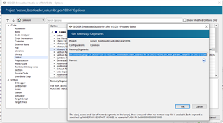

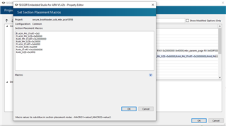

  • Hi Einar,
    The memory layout is FLASH1 RX 0x0 0x80000;RAM1 RWX 0x20000000 0x40000;mbr_params_page RX 0x000FE000 0x1000;bootloader_settings_page RX 0x000FF000 0x1000;uicr_bootloader_start_address RX 0x10001014 0x4;uicr_mbr_params_page RX 0x10001018 0x4.
    The second screenshot is what is most relevant here. Here you have starta address (FLASH_START) at 0xf4000, and this is way outside of the physical flash of the nRF52833 (512 kB flash). You must set this to something more sensible, something like 0x74000.
    In SDK 17.1.0., I am trying to build a bootloader based on the secure_bootloader_usb_mbr_pca10100e because it already has the crypto needed (when migrating from a 10056 example we had to do this manually). I had to download and build uECC. I could flash the bootloader first development kit its worked.

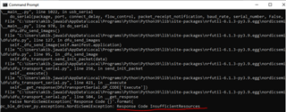

    1. nrfutil dfu usb-serial -pkg blinky_mbr.zip -p COM14
    Then i have tried with our custom PCB where its worked with blinky_mbr example.
    and then after i have tried with our firmware so it is thronging resource related error.
    Then again i have tried with some small firmware then it's able to programmed.

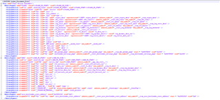

    Bootloader:
    <!DOCTYPE Linker_Placement_File>
    <Root name="Flash Section Placement">
      <MemorySegment name="FLASH1" start="$(FLASH_PH_START)" size="$(FLASH_PH_SIZE)">
        <ProgramSection load="no" name=".reserved_flash" start="$(FLASH_PH_START)" size="$(FLASH_START)-$(FLASH_PH_START)" />
        <ProgramSection alignment="0x100" load="Yes" name=".vectors" start="$(FLASH_START)" />
        <ProgramSection alignment="4" load="Yes" name=".init" />
        <ProgramSection alignment="4" load="Yes" name=".init_rodata" />
        <ProgramSection alignment="4" load="Yes" name=".text" size="0x4" />
        <ProgramSection alignment="4" keep="Yes" load="Yes" name=".crypto_data" inputsections="*(SORT(.crypto_data*))" address_symbol="__start_crypto_data" end_symbol="__stop_crypto_data" />
        <ProgramSection alignment="4" keep="Yes" load="Yes" name=".dfu_trans" inputsections="*(SORT(.dfu_trans*))" address_symbol="__start_dfu_trans" end_symbol="__stop_dfu_trans" />
        <ProgramSection alignment="4" keep="Yes" load="Yes" name=".nrf_queue" inputsections="*(.nrf_queue*)" address_symbol="__start_nrf_queue" end_symbol="__stop_nrf_queue" />
        <ProgramSection alignment="4" keep="Yes" load="Yes" name=".log_const_data" inputsections="*(SORT(.log_const_data*))" address_symbol="__start_log_const_data" end_symbol="__stop_log_const_data" />
        <ProgramSection alignment="4" keep="Yes" load="Yes" name=".nrf_balloc" inputsections="*(.nrf_balloc*)" address_symbol="__start_nrf_balloc" end_symbol="__stop_nrf_balloc" />
        <ProgramSection alignment="4" keep="Yes" load="Yes" name=".log_backends" inputsections="*(SORT(.log_backends*))" address_symbol="__start_log_backends" end_symbol="__stop_log_backends" />
        <ProgramSection alignment="4" keep="Yes" load="No" name=".nrf_sections" address_symbol="__start_nrf_sections" />
        <ProgramSection alignment="4" keep="Yes" load="Yes" name=".fs_data"  inputsections="*(.fs_data*)" runin=".fs_data_run"/>
        <ProgramSection alignment="4" keep="Yes" load="Yes" name=".log_dynamic_data"  inputsections="*(SORT(.log_dynamic_data*))" runin=".log_dynamic_data_run"/>
        <ProgramSection alignment="4" keep="Yes" load="Yes" name=".log_filter_data"  inputsections="*(SORT(.log_filter_data*))" runin=".log_filter_data_run"/>
        <ProgramSection alignment="4" load="Yes" name=".dtors" />
        <ProgramSection alignment="4" load="Yes" name=".ctors" />
        <ProgramSection alignment="4" load="Yes" name=".rodata" size="0x4" />
        <ProgramSection alignment="4" load="Yes" name=".ARM.exidx" address_symbol="__exidx_start" end_symbol="__exidx_end" />
        <ProgramSection alignment="4" load="Yes" runin=".fast_run" name=".fast" />
        <ProgramSection alignment="4" load="Yes" runin=".data_run" name=".data" />
        <ProgramSection alignment="4" load="Yes" runin=".tdata_run" name=".tdata" />
        <ProgramSection alignment="4" keep="Yes" load="No" name=".mbr_params_page" address_symbol="__start_mbr_params_page" end_symbol="__stop_mbr_params_page" start = "0x0007E000" size="0x1000" />
        <ProgramSection alignment="4" keep="Yes" load="No" name=".bootloader_settings_page" address_symbol="__start_bootloader_settings_page" end_symbol="__stop_bootloader_settings_page" start = "0x0007F000" size="0x1000" />
      </MemorySegment>
      <MemorySegment name="RAM1" start="$(RAM_PH_START)" size="$(RAM_PH_SIZE)">
        <ProgramSection load="no" name=".reserved_ram" start="$(RAM_PH_START)" size="$(RAM_START)-$(RAM_PH_START)" />
        <ProgramSection alignment="0x100" load="No" name=".vectors_ram" start="$(RAM_START)" address_symbol="__app_ram_start__"/>
        <ProgramSection alignment="4" keep="Yes" load="No" name=".nrf_sections_run" address_symbol="__start_nrf_sections_run" />
        <ProgramSection alignment="4" keep="Yes" load="No" name=".fs_data_run" address_symbol="__start_fs_data" end_symbol="__stop_fs_data" />
        <ProgramSection alignment="4" keep="Yes" load="No" name=".log_dynamic_data_run" address_symbol="__start_log_dynamic_data" end_symbol="__stop_log_dynamic_data" />
        <ProgramSection alignment="4" keep="Yes" load="No" name=".log_filter_data_run" address_symbol="__start_log_filter_data" end_symbol="__stop_log_filter_data" />
        <ProgramSection alignment="4" keep="Yes" load="No" name=".nrf_sections_run_end" address_symbol="__end_nrf_sections_run" />
        <ProgramSection alignment="4" load="No" name=".fast_run" />
        <ProgramSection alignment="4" load="No" name=".data_run" />
        <ProgramSection alignment="4" load="No" name=".tdata_run" />
        <ProgramSection alignment="4" load="No" name=".bss" />
        <ProgramSection alignment="4" load="No" name=".tbss" />
        <ProgramSection alignment="4" load="No" name=".non_init" />
        <ProgramSection alignment="4" size="__HEAPSIZE__" load="No" name=".heap" />
        <ProgramSection alignment="8" size="__STACKSIZE__" load="No" place_from_segment_end="Yes" name=".stack"  address_symbol="__StackLimit" end_symbol="__StackTop"/>
        <ProgramSection alignment="8" size="__STACKSIZE_PROCESS__" load="No" name=".stack_process" />
      </MemorySegment>
      <MemorySegment name="uicr_bootloader_start_address" start="0x10001014" size="0x4">
        <ProgramSection alignment="4" keep="Yes" load="Yes" name=".uicr_bootloader_start_address" address_symbol="__start_uicr_bootloader_start_address" end_symbol="__stop_uicr_bootloader_start_address" start = "0x10001014" size="0x4" />
      </MemorySegment>
      <MemorySegment name="uicr_mbr_params_page" start="0x10001018" size="0x4">
        <ProgramSection alignment="4" keep="Yes" load="Yes" name=".uicr_mbr_params_page" address_symbol="__start_uicr_mbr_params_page" end_symbol="__stop_uicr_mbr_params_page" start = "0x10001018" size="0x4" />
      </MemorySegment>
    </Root>
