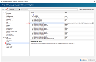

    It seems like you are missing the SoftDevice. If you flash an example project that depend on the SoftDevice from SES, that will also flash the SoftDevice, as it is an additional load file. See here:
    The SoftDevice is not part of your application hex, so if using something else you need to also add and flash the SoftDevice hex file. With nRF Connect Programmer simply add the SoftDevice hex also before you press "Erase & write". You fill find the SoftDevices under <nRF5 SDK>\components\softdevice\.

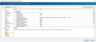

    we are not using any soft device but in loader section MBR hex is added.
    So at time of flashing we ware added MBR hex file too then its looks good even serial port is detecting too but while updating device through bootloader it's throwing error.

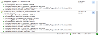

    even in nRf connect we can see that the memory layout is same.
    device flashed through nRf connect.
    device flashed through SES.
    And one strange thing i have observed too if i flash through SES and read device through nRf connect then it's throwing the same error.
