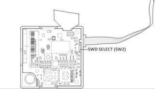

    Have you switched SWD SELECT (SW2) to nRF91?
    Markus
  • Yes the selector is on nRF91.
