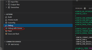

    • Then I built it using the board nrf5340dk_nrf5340_cpuapp

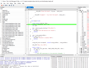

    • I opened an Ozone debug session and set a break point in main.c-->main()
    • No faults happened, since it's able to reach the break point
    Can you do the exact same and see if you get the same output?
  • A little more info: I tried this on an Intel Mac and M1 Mac with same results.  I am not using ozone.
  • Ah.. Of course. For some reason I thought it happened during the initialization that runs before main (I've handled many cases lately where this is the case :P. My bad.
  • I added CONFIG_ISR_STACK_SIZE=8192 and it seems to be working again.  My complete prj.conf is now:
