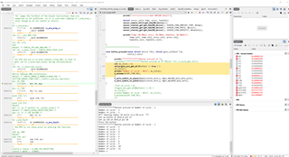

Hello everyone,
i need to increment a counter each time my button on the nrf534DK is pressed
i'm using sdk v 1.7.1 .
is there a simple way to do it or a function which supports this
do you have any example that can guide me through, so that i can implement and increment my counter each time the button is pressed .
i already have my button example running perfectly
i just need to implement a counter that increments by 1 each time the button is pressed
i did some researches and i saw that RTC counter need to be used
do you have an example on that or can you guide me through to get it done
the image below is showing how my button is pressed
1-button pressed ( printk("***************Button pressed at %" PRIu32 "\n", k_cycle_get_32());  k_cycle_get_32->Current hardware clock up-counter (in cycles)  )
2-get bme data
3-get Mpu data
knowing the details can you help me please implement the counter
feel free to provide me with any example that can help me
i really appreciate your help in advance
very thankful
kindly,
Rihab
  • Hello Community
    i'm currently trying to increment a counter every time the button is pressed
    the counter is considered like the number of cycle
    well i added some modification to my code to do this function
         int on_click = 0;
            while(gpio_pin_get_dt(&button) != true ) {
    	    on_click++;
            printk("Number of cycle : %d\n", on_click);
            k_msleep(SLEEP_TIME_MS);
    this function is part of my project
    and whole project role is :
    0-button pressed
    1-display BME280 values
    2-display MPU6050 values
    and now i'm trying to add the number of cycle which means technically how many times the button was pressed
    when i try to view the result on my debug Terminal
    it only displays the number of cycle and it doesn't display the values of the other 2 sensors
    and then 5 sec later it stops and it displays the disassembly window on the right just like below
    can anyone help me fix this please
    please if you know what is causing this tell me as soon as you can
    thank you in advance
    Kindly,
    Rihab

  • Hey Rihab,
    You are very close, but you need to study the programming concept of scope and how it affects variables. See https://www.tutorialspoint.com/cprogramming/c_scope_rules.htm.
    If you want to access the counter variable outside the button_pressed function you need to declare it as a global variable.
    or, if you only want to access the counter variable inside the function, you need to declare it as a static variable in order to keep its state in memory each time the button_pressed function is called. See https://www.tutorialspoint.com/static-variables-in-c.
  • thank you for you recommendation
    I made it through with your help
    here's my output from the result
    thank you very much
    very grateful
    ***************Button pressed at Number of cycle : 43
