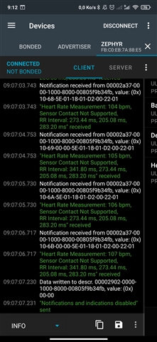

I was trying out sending RR intervals on the Heart Rate Measurement service and seeing what happens in nRF Connect. But, something is weird with the way the values are interpreted in the app. The flag for Energy Expended is set to 0, so there should not be any in the packet. But if bytes 2 and 3 of the hrm packet are used to send RR intervals , they are just ignored:
Whatever RR interval is in bytes 2 and 3 is straight up ignored.
Here is another example with putting RR intervals values from byte 4 onward instead of byte 2 onward:
This time, no RR Interval value is ignored!

    Here is a sample (build folder inside also has a .hex for nrf52840dk_nrf52840): Peripheral_RR_Interval_nRF_Connect_App.zip
    It alternates between sending the RR Intervals from byte 2 and byte 4 while keeping the EE flag deactivated.
    It shows this behavior:
    The RR-Interval with value 0x15e (341.80ms) is thus ignored on the display when place on byte 2 but not when placed on byte 4.
    I am using Android. As far as what I tried, iOS does not seem to offer an obvious way to interpret a heart rate measurement packet.

    I am discussing this with a colleague, and we're not able to see where the specification says that RR intervals should be from byte 2 onwards, in 2 byte format, could you point to it? We're currently investigating why the nRFConnect app is not printing the first RR interval, but don't have a conclusion yet. Thank you for your patience and thorough feedback. I've been able to reproduce it on my end, so it's not specific to your specific phone at least.
