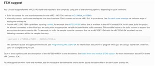

I tried SDK Connect v1.8.0 ble_peripheral_lbs_coex sample.
It found advertising signal was very weak. The distance between PCA10112 and my phone was 1 meter. RSSI was only -86dBm.
For PCA10056, at same situation, RSSI was -45dBm.
My PCA10112 was v0.9.1 version.
What is the reason? Shall I add configurations at prj.conf file to enable FEM?
