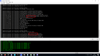

No peripheral connection after disconnect with Android App Nordic Uart Service until mac-address of smartphone changes
No connection after disconnect with Android App Nordic Uart Service until mac-address of smartphone changes
Multilink multirole software developed in SES studio.
Other smartphone can connect without reset of NRF52 or I should wait until first phone changes its mac-address.
No feedback (from any handle) from NRF52... just no connection
LOG from Android studio

  • Hi
    Please note that you can upload images and files to DevZone as well, so you don't have to upload it on a separate link.
    I don't see any retries during connection here, which is what generally fixes the 0x85 error you're seeing. Just for reference, is your nRF application running on a Development Kit or a custom board?
    Please also try uploading a sniffer trace of the on-air activity if you can.
    Simon
  • I don't see any retries during connection here,
    I can`t reconnect because button become unclickable
    I try to connect to nrf52833dk with smartphone Blackview4900 Android10
    No callback in nrf52

    264    6.934634    dc:9d:05:72:99:ce    Broadcast    LE LL    55    ADV_IND
    265    7.036264    dc:9d:05:72:99:ce    Broadcast    LE LL    55    ADV_IND
    266    7.036852    dc:9d:05:72:99:ce    Broadcast    LE LL    55    ADV_IND
    267    7.037440    dc:9d:05:72:99:ce    Broadcast    LE LL    55    ADV_IND
    268    7.139490    dc:9d:05:72:99:ce    Broadcast    LE LL    55    ADV_IND
    269    7.140078    dc:9d:05:72:99:ce    Broadcast    LE LL    55    ADV_IND
    270    7.140540    52:98:91:73:bc:0d    dc:9d:05:72:99:ce    LE LL    38    SCAN_REQ
    271    7.140865    dc:9d:05:72:99:ce    Broadcast    LE LL    50    SCAN_RSP
    272    7.243833    dc:9d:05:72:99:ce    Broadcast    LE LL    55    ADV_IND
    273    7.344172    dc:9d:05:72:99:ce    Broadcast    LE LL    55    ADV_IND
    274    7.344760    dc:9d:05:72:99:ce    Broadcast    LE LL    55    ADV_IND
    275    7.345222    52:98:91:73:bc:0d    dc:9d:05:72:99:ce    LE LL    38    SCAN_REQ
    276    7.345548    dc:9d:05:72:99:ce    Broadcast    LE LL    50    SCAN_RSP
    277    7.345890    dc:9d:05:72:99:ce    Broadcast    LE LL    55    ADV_IND
    278    7.441143    dc:9d:05:72:99:ce    Broadcast    LE LL    55    ADV_IND
    279    7.441733    dc:9d:05:72:99:ce    Broadcast    LE LL    55    ADV_IND
    280    7.442321    dc:9d:05:72:99:ce    Broadcast    LE LL    55    ADV_IND
    281    7.535826    dc:9d:05:72:99:ce    Broadcast    LE LL    55    ADV_IND
    282    7.536416    dc:9d:05:72:99:ce    Broadcast    LE LL    55    ADV_IND
    283    7.537004    dc:9d:05:72:99:ce    Broadcast    LE LL    55    ADV_IND
    284    7.635635    dc:9d:05:72:99:ce    Broadcast    LE LL    55    ADV_IND
    285    7.636225    dc:9d:05:72:99:ce    Broadcast    LE LL    55    ADV_IND
    286    7.636687    52:98:91:73:bc:0d    dc:9d:05:72:99:ce    LE LL    38    SCAN_REQ
    287    7.637013    dc:9d:05:72:99:ce    Broadcast    LE LL    50    SCAN_RSP
    288    7.637355    dc:9d:05:72:99:ce    Broadcast    LE LL    55    ADV_IND
    289    7.732514    dc:9d:05:72:99:ce    Broadcast    LE LL    55    ADV_IND
    290    7.733101    dc:9d:05:72:99:ce    Broadcast    LE LL    55    ADV_IND
    291    7.733689    dc:9d:05:72:99:ce    Broadcast    LE LL    55    ADV_IND
    292    7.830705    dc:9d:05:72:99:ce    Broadcast    LE LL    55    ADV_IND
    293    7.831293    dc:9d:05:72:99:ce    Broadcast    LE LL    55    ADV_IND
    294    7.831881    dc:9d:05:72:99:ce    Broadcast    LE LL    55    ADV_IND
    295    7.832343    52:98:91:73:bc:0d    dc:9d:05:72:99:ce    LE LL    60    CONNECT_IND
    296    7.933046    dc:9d:05:72:99:ce    Broadcast    LE LL    55    ADV_IND
    297    7.933634    dc:9d:05:72:99:ce    Broadcast    LE LL    55    ADV_IND
    298    7.934224    dc:9d:05:72:99:ce    Broadcast    LE LL    55    ADV_IND
    299    8.030506    dc:9d:05:72:99:ce    Broadcast    LE LL    55    ADV_IND
    300    8.030968    52:98:91:73:bc:0d    dc:9d:05:72:99:ce    LE LL    38    SCAN_REQ
    301    8.031294    dc:9d:05:72:99:ce    Broadcast    LE LL    50    SCAN_RSP
    302    8.031636    dc:9d:05:72:99:ce    Broadcast    LE LL    55    ADV_IND
    303    8.032224    dc:9d:05:72:99:ce    Broadcast    LE LL    55    ADV_IND
    304    8.124273    dc:9d:05:72:99:ce    Broadcast    LE LL    55    ADV_IND
    305    8.124863    dc:9d:05:72:99:ce    Broadcast    LE LL    55    ADV_IND
    306    8.125325    52:98:91:73:bc:0d    dc:9d:05:72:99:ce    LE LL    38    SCAN_REQ
    307    8.125651    dc:9d:05:72:99:ce    Broadcast    LE LL    50    SCAN_RSP
    308    8.125993    dc:9d:05:72:99:ce    Broadcast    LE LL    55    ADV_IND
    309    8.225515    dc:9d:05:72:99:ce    Broadcast    LE LL    55    ADV_IND
    310    8.226103    dc:9d:05:72:99:ce    Broadcast    LE LL    55    ADV_IND
    311    8.226691    dc:9d:05:72:99:ce    Broadcast    LE LL    55    ADV_IND
    312    8.321631    dc:9d:05:72:99:ce    Broadcast    LE LL    55    ADV_IND
    313    8.322212    dc:9d:05:72:99:ce    Broadcast    LE LL    55    ADV_IND
    314    8.322674    52:98:91:73:bc:0d    dc:9d:05:72:99:ce    LE LL    38    SCAN_REQ
    315    8.323000    dc:9d:05:72:99:ce    Broadcast    LE LL    50    SCAN_RSP
    316    8.323341    dc:9d:05:72:99:ce    Broadcast    LE LL    55    ADV_IND
    317    8.420738    dc:9d:05:72:99:ce    Broadcast    LE LL    55    ADV_IND
    318    8.421326    dc:9d:05:72:99:ce    Broadcast    LE LL    55    ADV_IND
    319    8.421909    dc:9d:05:72:99:ce    Broadcast    LE LL    55    ADV_IND
    320    8.422370    52:98:91:73:bc:0d    dc:9d:05:72:99:ce    LE LL    38    SCAN_REQ
    321    8.422696    dc:9d:05:72:99:ce    Broadcast    LE LL    50    SCAN_RSP
    322    8.521767    dc:9d:05:72:99:ce    Broadcast    LE LL    55    ADV_IND
    323    8.522355    dc:9d:05:72:99:ce    Broadcast    LE LL    55    ADV_IND
    324    8.522943    dc:9d:05:72:99:ce    Broadcast    LE LL    55    ADV_IND
    325    8.523405    52:98:91:73:bc:0d    dc:9d:05:72:99:ce    LE LL    38    SCAN_REQ
    326    8.523731    dc:9d:05:72:99:ce    Broadcast    LE LL    50    SCAN_RSP
    327    8.620813    dc:9d:05:72:99:ce    Broadcast    LE LL    55    ADV_IND
    328    8.621403    dc:9d:05:72:99:ce    Broadcast    LE LL    55    ADV_IND
    329    8.621991    dc:9d:05:72:99:ce    Broadcast    LE LL    55    ADV_IND
    330    8.622453    52:98:91:73:bc:0d    dc:9d:05:72:99:ce    LE LL    38    SCAN_REQ
    331    8.622779    dc:9d:05:72:99:ce    Broadcast    LE LL    50    SCAN_RSP
    332    8.715373    dc:9d:05:72:99:ce    Broadcast    LE LL    55    ADV_IND
    333    8.715953    dc:9d:05:72:99:ce    Broadcast    LE LL    55    ADV_IND
    334    8.716541    dc:9d:05:72:99:ce    Broadcast    LE LL    55    ADV_IND
    335    8.811856    dc:9d:05:72:99:ce    Broadcast    LE LL    55    ADV_IND
    336    8.812318    52:98:91:73:bc:0d    dc:9d:05:72:99:ce    LE LL    38    SCAN_REQ
    337    8.812644    dc:9d:05:72:99:ce    Broadcast    LE LL    50    SCAN_RSP
    338    8.812986    dc:9d:05:72:99:ce    Broadcast    LE LL    55    ADV_IND
    339    8.813574    dc:9d:05:72:99:ce    Broadcast    LE LL    55    ADV_IND
    340    8.906447    dc:9d:05:72:99:ce    Broadcast    LE LL    55    ADV_IND
    341    8.906908    52:98:91:73:bc:0d    dc:9d:05:72:99:ce    LE LL    38    SCAN_REQ
    342    8.907235    dc:9d:05:72:99:ce    Broadcast    LE LL    50    SCAN_RSP
    343    8.907576    dc:9d:05:72:99:ce    Broadcast    LE LL    55    ADV_IND
    344    8.908164    dc:9d:05:72:99:ce    Broadcast    LE LL    55    ADV_IND
    345    9.003600    dc:9d:05:72:99:ce    Broadcast    LE LL    55    ADV_IND
    346    9.004062    52:98:91:73:bc:0d    dc:9d:05:72:99:ce    LE LL    38    SCAN_REQ
    347    9.004387    dc:9d:05:72:99:ce    Broadcast    LE LL    50    SCAN_RSP
    348    9.004729    dc:9d:05:72:99:ce    Broadcast    LE LL    55    ADV_IND
    349    9.005317    dc:9d:05:72:99:ce    Broadcast    LE LL    55    ADV_IND
    350    9.106674    dc:9d:05:72:99:ce    Broadcast    LE LL    55    ADV_IND
    351    9.107135    52:98:91:73:bc:0d    dc:9d:05:72:99:ce    LE LL    38    SCAN_REQ
    352    9.107461    dc:9d:05:72:99:ce    Broadcast    LE LL    50    SCAN_RSP
    353    9.107802    dc:9d:05:72:99:ce    Broadcast    LE LL    55    ADV_IND
    354    9.108390    dc:9d:05:72:99:ce    Broadcast    LE LL    55    ADV_IND
    355    9.210328    dc:9d:05:72:99:ce    Broadcast    LE LL    55    ADV_IND
    356    9.210790    52:98:91:73:bc:0d    dc:9d:05:72:99:ce    LE LL    38    SCAN_REQ
    357    9.211116    dc:9d:05:72:99:ce    Broadcast    LE LL    50    SCAN_RSP
    358    9.211458    dc:9d:05:72:99:ce    Broadcast    LE LL    55    ADV_IND
    359    9.212046    dc:9d:05:72:99:ce    Broadcast    LE LL    55    ADV_IND
    360    9.311266    dc:9d:05:72:99:ce    Broadcast    LE LL    55    ADV_IND
    361    9.311727    52:98:91:73:bc:0d    dc:9d:05:72:99:ce    LE LL    38    SCAN_REQ
    362    9.312054    dc:9d:05:72:99:ce    Broadcast    LE LL    50    SCAN_RSP
    363    9.406871    dc:9d:05:72:99:ce    Broadcast    LE LL    55    ADV_IND
    364    9.407459    dc:9d:05:72:99:ce    Broadcast    LE LL    55    ADV_IND
    365    9.504352    dc:9d:05:72:99:ce    Broadcast    LE LL    55    ADV_IND
    366    9.504942    dc:9d:05:72:99:ce    Broadcast    LE LL    55    ADV_IND
    367    9.505404    52:98:91:73:bc:0d    dc:9d:05:72:99:ce    LE LL    38    SCAN_REQ
    368    9.505729    dc:9d:05:72:99:ce    Broadcast    LE LL    50    SCAN_RSP
    369    9.506071    dc:9d:05:72:99:ce    Broadcast    LE LL    55    ADV_IND
    370    9.606998    dc:9d:05:72:99:ce    Broadcast    LE LL    55    ADV_IND
    371    9.607588    dc:9d:05:72:99:ce    Broadcast    LE LL    55    ADV_IND
    372    9.608176    dc:9d:05:72:99:ce    Broadcast    LE LL    55    ADV_IND
    373    9.608638    52:98:91:73:bc:0d    dc:9d:05:72:99:ce    LE LL    60    CONNECT_IND
    374    9.708546    dc:9d:05:72:99:ce    Broadcast    LE LL    55    ADV_IND
    375    9.709134    dc:9d:05:72:99:ce    Broadcast    LE LL    55    ADV_IND
    376    9.709722    dc:9d:05:72:99:ce    Broadcast    LE LL    55    ADV_IND
    377    9.810155    dc:9d:05:72:99:ce    Broadcast    LE LL    55    ADV_IND
    378    9.810743    dc:9d:05:72:99:ce    Broadcast    LE LL    55    ADV_IND
    379    9.811331    dc:9d:05:72:99:ce    Broadcast    LE LL    55    ADV_IND
    380    9.907005    dc:9d:05:72:99:ce    Broadcast    LE LL    55    ADV_IND
    381    9.907592    dc:9d:05:72:99:ce    Broadcast    LE LL    55    ADV_IND
    382    9.908181    dc:9d:05:72:99:ce    Broadcast    LE LL    55    ADV_IND
    383    10.004677    dc:9d:05:72:99:ce    Broadcast    LE LL    55    ADV_IND
    384    10.005265    dc:9d:05:72:99:ce    Broadcast    LE LL    55    ADV_IND
    385    10.005853    dc:9d:05:72:99:ce    Broadcast    LE LL    55    ADV_IND
    386    10.105615    dc:9d:05:72:99:ce    Broadcast    LE LL    55    ADV_IND
    387    10.106202    dc:9d:05:72:99:ce    Broadcast    LE LL    55    ADV_IND
    388    10.106663    52:98:91:73:bc:0d    dc:9d:05:72:99:ce    LE LL    38    SCAN_REQ
    389    10.106989    dc:9d:05:72:99:ce    Broadcast    LE LL    50    SCAN_RSP
    390    10.107331    dc:9d:05:72:99:ce    Broadcast    LE LL    55    ADV_IND
    391    10.208200    dc:9d:05:72:99:ce    Broadcast    LE LL    55    ADV_IND
    392    10.208788    dc:9d:05:72:99:ce    Broadcast    LE LL    55    ADV_IND
    393    10.209251    52:98:91:73:bc:0d    dc:9d:05:72:99:ce    LE LL    38    SCAN_REQ
    394    10.209576    dc:9d:05:72:99:ce    Broadcast    LE LL    50    SCAN_RSP
    395    10.306804    dc:9d:05:72:99:ce    Broadcast    LE LL    55    ADV_IND
    396    10.408610    dc:9d:05:72:99:ce    Broadcast    LE LL    55    ADV_IND
    397    10.409198    dc:9d:05:72:99:ce    Broadcast    LE LL    55    ADV_IND
    398    10.409660    52:98:91:73:bc:0d    dc:9d:05:72:99:ce    LE LL    38    SCAN_REQ
    399    10.409986    dc:9d:05:72:99:ce    Broadcast    LE LL    50    SCAN_RSP
    400    10.410327    dc:9d:05:72:99:ce    Broadcast    LE LL    55    ADV_IND
    401    10.505489    dc:9d:05:72:99:ce    Broadcast    LE LL    55    ADV_IND
    402    10.506079    dc:9d:05:72:99:ce    Broadcast    LE LL    55    ADV_IND
    403    10.506667    dc:9d:05:72:99:ce    Broadcast    LE LL    55    ADV_IND
    404    10.608837    dc:9d:05:72:99:ce    Broadcast    LE LL    55    ADV_IND
    405    10.609299    52:98:91:73:bc:0d    dc:9d:05:72:99:ce    LE LL    38    SCAN_REQ
    406    10.609625    dc:9d:05:72:99:ce    Broadcast    LE LL    50    SCAN_RSP
    407    10.609967    dc:9d:05:72:99:ce    Broadcast    LE LL    55    ADV_IND
    408    10.610555    dc:9d:05:72:99:ce    Broadcast    LE LL    55    ADV_IND
    409    10.710019    dc:9d:05:72:99:ce    Broadcast    LE LL    55    ADV_IND
    410    10.710480    52:98:91:73:bc:0d    dc:9d:05:72:99:ce    LE LL    38    SCAN_REQ
    411    10.710807    dc:9d:05:72:99:ce    Broadcast    LE LL    50    SCAN_RSP
    412    10.711149    dc:9d:05:72:99:ce    Broadcast    LE LL    55    ADV_IND
    413    10.711738    dc:9d:05:72:99:ce    Broadcast    LE LL    55    ADV_IND
    414    10.813031    dc:9d:05:72:99:ce    Broadcast    LE LL    55    ADV_IND
    415    10.813619    dc:9d:05:72:99:ce    Broadcast    LE LL    55    ADV_IND
    416    10.814202    dc:9d:05:72:99:ce    Broadcast    LE LL    55    ADV_IND
    417    10.909545    dc:9d:05:72:99:ce    Broadcast    LE LL    55    ADV_IND
    418    10.910135    dc:9d:05:72:99:ce    Broadcast    LE LL    55    ADV_IND
    419    10.910723    dc:9d:05:72:99:ce    Broadcast    LE LL    55    ADV_IND
    420    11.006851    dc:9d:05:72:99:ce    Broadcast    LE LL    55    ADV_IND
    421    11.007439    dc:9d:05:72:99:ce    Broadcast    LE LL    55    ADV_IND
    422    11.007901    52:98:91:73:bc:0d    dc:9d:05:72:99:ce    LE LL    38    SCAN_REQ
    423    11.008227    dc:9d:05:72:99:ce    Broadcast    LE LL    50    SCAN_RSP
    424    11.008569    dc:9d:05:72:99:ce    Broadcast    LE LL    55    ADV_IND
    425    11.108673    dc:9d:05:72:99:ce    Broadcast    LE LL    55    ADV_IND
    426    11.109261    dc:9d:05:72:99:ce    Broadcast    LE LL    55    ADV_IND
    427    11.109723    52:98:91:73:bc:0d    dc:9d:05:72:99:ce    LE LL    38    SCAN_REQ
    428    11.110049    dc:9d:05:72:99:ce    Broadcast    LE LL    50    SCAN_RSP
    429    11.110391    dc:9d:05:72:99:ce    Broadcast    LE LL    55    ADV_IND
    430    11.204332    dc:9d:05:72:99:ce    Broadcast    LE LL    55    ADV_IND
    431    11.204920    dc:9d:05:72:99:ce    Broadcast    LE LL    55    ADV_IND
    432    11.205508    dc:9d:05:72:99:ce    Broadcast    LE LL    55    ADV_IND
    433    11.305026    dc:9d:05:72:99:ce    Broadcast    LE LL    55    ADV_IND
    434    11.305488    52:98:91:73:bc:0d    dc:9d:05:72:99:ce    LE LL    38    SCAN_REQ
    435    11.305814    dc:9d:05:72:99:ce    Broadcast    LE LL    50    SCAN_RSP

  • Hi
    By "retries during the connection" I mean that you need to implement some retries on the nRF application side so that it automatically tries to connect again if it fails. The latest BLE sniffer trace you have uploaded does not seem to be correct, as there are no advertisements, or connection requests/responses and disconnects here.
    Simon
  • Hi Dear!
    Thanks for reply
    1800    49.442909    dc:9d:05:72:99:ce    Broadcast    LE LL    55    ADV_IND
    is this not advertisements?
    That is the problem!!! I cant reconnect (((((
    BTW I found that if while this problem I turn on "fty mode" on smartphone and then turn off it I can connect - but as I told above it happen because mac-address of smartphone changes. And this I done with different smartphones - the same situation.
    I cant understand what is this
