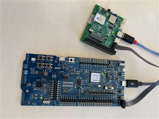

No longer able to program custom nRF52840 over SWD. No idcode detected
I had been able to program my custom nRF52840 just fine until I wanted to change partitions. I erased everything and now am unable to communicate with the board at all. I get "Failed to connect to target. No idcode detected. Please check connection and Target Interface Type."
When I try to recover the board, I get:
>nrfjprog --recover --family NRF52 --log

I'm using an nRF52840 DK to program the boards and it has no problem programming other boards. Not sure what I need to do to get the custom boards working again.
  • Where am I measuring VTG? I ran nrfjprog twice. Before is DK powered up first, custom board 2nd. After is custom board powered first and DK second.
    Before:

  • Hi again,
    Can you show me how you have connected your custom board to the DK? It should be connected like the image below, where the VTG is connected to VDD on the custom board and DK.
    Simon
  • I see, that should make sure the connection is set up properly at least. After discussing this issue with some colleagues we don't see any reason that changing the storage partitions should have caused the external board to not be found when trying to recover it. In at least one of the logs you have uploaded, the computer doesn't seem to be able to communicate DK, which sounds like the onboard debugger is busy with a debug session for example. So you should make sure that the DK is "free" before running an nrfjprog command.
    Either way, the issue here is that you're not able to communicate with external board, can you try checking, with a multi-meter for instance, what voltage the external board is operating on? Worst case scenario is that the external board's nRF52840 is in a reset-loop, which also would lead to this behavior, and the only remedy here is to try and try again in hopes of recovering the device "between" these reset loops.
    Simon
