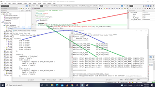

Dear, I defined Port1 pins as in attached overlay file. The binding of pins is done as in lcd.h attached file. When, build is started, the error written in title is displayed and build failed. Please guide, how to fix this issue.

Dear PY, I tried by including .h in .c files rather than in CMakeLists.txt, but in both cases same error ..varible .. incomplete ... also see next error is related to SPEC_DT ..... ?

Hi PY, I have done all the changes. The erros and warinings are shown in attached iamge. The project Zip file also attached. I am using SES and nRF1.71.

Dear PY, after rearranging the files, the CMake and Buld is successful. When Debug is run, the custom pin have no address assigned by inilization library. See the image. The whole project Zip is also attached.
