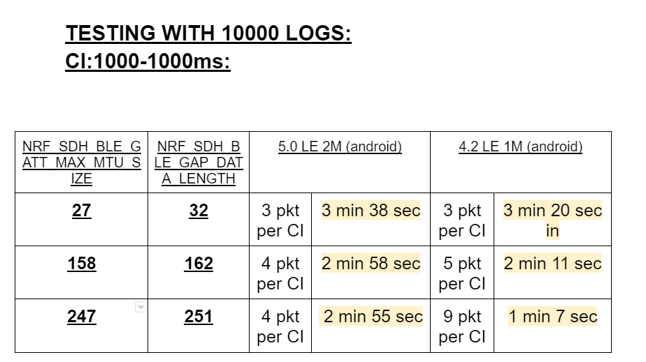

  • Simonr,
    I have tested BLE 5.0 LE 1M phy and BLE LE 2M Phy
    i took 10,000 logs of 12 bytes data at 2 secs interval.
    I am able to receive the logs
    #define MIN_CONN_INTERVAL MSEC_TO_UNITS(1000, UNIT_1_25_MS) /*
    #define MAX_CONN_INTERVAL MSEC_TO_UNITS(1000, UNIT_1_25_MS) /*
    NRF_SDH_BLE_GAP_DATA_LENGTH 31/162/251
    NRF_SDH_BLE_GATT_MAX_MTU_SIZE 27/158/247
    WITH these combinations on sniffer i found:
    My issue is that why in LE 2M same data is taking more time compared to LE 1M?
  • Hi
    That sounds very strange. What I'm most skeptical to is the fact that the 1MBPS PHY with 247 byte MTU size lets you do 9 packets per conn. interval, and this is halved for the 2MBPS version of the transmission. At what range are you testing this throughput?
    Simon
