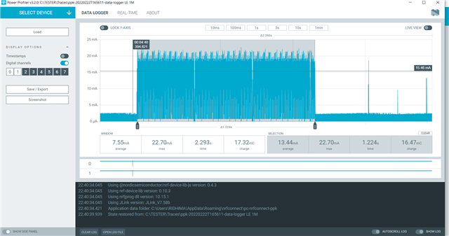

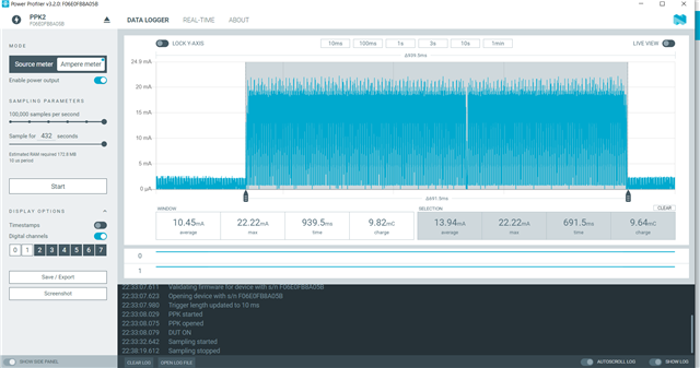

  • Hello Simonr,
    I have taken 10k logs for a data  which was 12 bytes .
    i have ci set as 400 ms
    i tested it for Le 2m and Le 1m
    i am able to receive data in LE 2m in lesser times as compared to Le 1m.
    My concern is now that which PHY ie LE 1m or Le 2m consumes much power sending same amount of data?
    This is trace when LE 1m phy is enabled
    This trace is when le 2m phy is enabled
