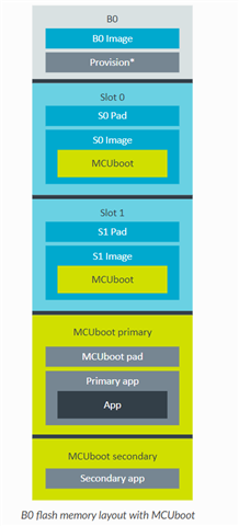

    I've reverted the project and started to add DFU again from scratch, following the Bootloaders and Device Firmware Updates, but again the same. The way this looks, I've omitted some (most likely very basic) crucial step.
    Lets have a quick look at the project - just in case:
    It's a Bluetooth Mesh application running a custom mesh model. It was originally built on the chat example from NCS 1.7.1. NCS has been updated to 1.8.0 since. It's running on a nRF52832, which is connected through an nRF52840 DK. Is there any special treatment needed if the target (nRF52832) is connected through the DK?

  • Hi Michael,
    If you have a look here   you can find the memory layout as follows:
    In your case, the partition.yml shows mcuboot_primary_app is from 0x22200 to 0x50000 which mean it has only 187904 bytes for the application.
    I did a quick check with the chat application (without SMP_SVR to receive image via BLE) the application size is already  292616 kB.
    The problem is that MCUBoot is made to only support dual bank update (unless it's in UART recovery mode) so the primary bank and the secondary bank have to have the same size.
    In this case the nRF52832 may not have enough flash size. You may want to consider the nRF52840.

  • Hi Mike,
    Have you tried the prj_minimal.conf in the mcu_boot project ? It will reduce the size of the MCUBoot down to 31kB.
    With that and without the immutable bootloader, I can see that the application primary slot is defined from address 0x8000 to 0x44000 meaning you have 240kB for the application. Would your application fit in ?
    I don't thinking going for an earlier version of the SDK is a good idea. It doesn't sound future proof to me.
    We can think about reducing the size of the mesh stack and the BLE stack (this is one of the advantages of Zephyr compare to softdevice that you can choose which features to include in the stack).
    For example you can think of removing any feature related to 2Mbps, Data length extension?
