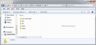

    I did as you said. The error in SES persists as can be seen in the attached images.
    Can you confirm that the path is correct? It has to point to a folder containing the following subfolders including content:
    Markus

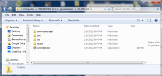

    Yes, the directory structure is the one indicated by you as can be seen in the image below:
    Also in the initial option the structure of the directories is the same:
    I think the error is at the SES level.
    Neculai

    Correction from my side. The path C:\Users\Culi\ncs\v1.8.0\toolchain\opt is correct. My apologies for that!
    Could you share a full application build log with the Asset Tracker v2 from the bash? I would like to check the toolchain configurations.
