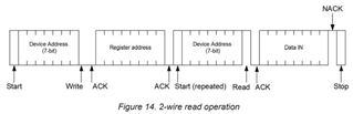

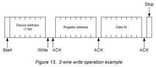

  • I believe you are mixing a bit the Device (slave) address with the Register address(es). There are two typical sequences in 2-wire (I2C) transactions, to illustrate the write and read operations you can look at the below Figures:
    I suggest that you add a logic analyzer to the 2-wire (I2C) pins to see the actual data.

  • Hi Kenneth,
        I am not having logic analyzer. I am not confusing between 2 addresses. I understand that slave address is used as an identifier by the master and register address is internal addresses of the slave device. But in my case, I dont have any registers in my slave device. So how to send data?? What to put in place of register address?
    Thanks & Regards,
    Snehal.
