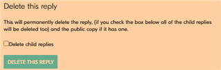

    (By the way I tried to delete the post below, when I do so I get a side popup saying "do you want to delete"but nowhere to say "yes"  .... :-) )

    Can you show me a screenshot of how your "delete" button looks? Does it not look like this? I at least have an option to "Delete this reply", but that might be my settings as a mod making it look like this.
    Simon
  • hmmm, now it seems to be working - OK, never mind.
