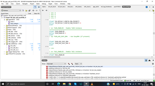

Hiii... Team,
I am developing a project based on the nRF52833 with the nRF5 SDK 17.0.2 and Soft Device S140
code is successfully built.. when i try to debug it showing problem
it shows ("Unknow function at 0x00000A60")
Actually i m using the nrf52832 kit as a "debugger" and my external module is nrf52833.
in simple way i m flashing the code in nrf52833 with help of nrf52832 development kit.
i m uploading the screenshot and my project folder as well.
please help to solve it.
plese open the zip file as given path
C:\nRF5_SDK_17.0.2_d674dde\examples\ble_peripheral\ble_app_uart\pca10056\s140\ses
thanks in advance. 0020.ble_app_uart.zip
  • Hi....
    as per your suggestion I set the 'TWI0_ENABLED as 1
    but now its showing more errors..
    Please upload your current PCA10100 here so I can take a look. You seem to be missing a few more sdk_config settings and/or source files.

    You had not enabled the TWI and you had not included your own source files:
    /modules/nrfx/mdk/nrf52840.svd"
           debug_start_from_entry_point_symbol="No"
    diff --git a/pca10100/s140/config/sdk_config.h b/pca10100/s140/config/sdk_config.h
    index ed6724a..301aa86 100644
    --- a/pca10100/s140/config/sdk_config.h
    +++ b/pca10100/s140/config/sdk_config.h
    @@ -5719,7 +5719,7 @@
     // <e> TWI_ENABLED - nrf_drv_twi - TWI/TWIM peripheral driver - legacy layer
     #ifndef TWI_ENABLED
    -#define TWI_ENABLED 0
    +#define TWI_ENABLED 1
     // <o> TWI_DEFAULT_CONFIG_FREQUENCY  - Frequency
    diff --git a/pca10100/s140/ses/ble_app_uart_pca10100_s140.emProject b/pca10100/s140/ses/ble_app_uart_pca10100_s140.emProject
    index 9e41783..6b0d85a 100644
    --- a/pca10100/s140/ses/ble_app_uart_pca10100_s140.emProject
    +++ b/pca10100/s140/ses/ble_app_uart_pca10100_s140.emProject
    @@ -70,6 +70,10 @@
           <file file_name="../../../../../../components/libraries/strerror/nrf_strerror.c" />
           <file file_name="../../../../../../components/libraries/uart/retarget.c" />
         </folder>
    +    <folder Name="cus_ext_drv">
    +      <file file_name="heartrate_cus.c" />
    +      <file file_name="accel5_cus.c" />
    +    </folder>
         <folder Name="None">
           <file file_name="../../../../../../modules/nrfx/mdk/ses_startup_nrf52833.s" />
           <file file_name="../../../../../../modules/nrfx/mdk/ses_startup_nrf_common.s" />
    Here is the updated project:
    ble_app_uart_283383.zip
    thats compiled..
    thanku so much :)
