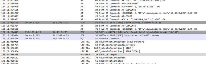

We are currently certifying our module for Verizon in the US.  As such, we are updating our software to work with MFW v1.3.0 and the corresponding NCS version v1.7.0.  The upgrade went relatively smoothing and things are generally working as we'd expect.  Our device will connect either over the CATM1 or NBIOT network (configurable) and then connect to an MQTT broker and send data up.  However, we have encountered an issue and require some assistance in troubleshooting it.
When we connect specifically over Vodafone (AT&T in my area) using CATM1 (using SYSTEMMODE set to both CATM1/NBIOT supported w/ LTE Preference = M1 Preferred), we will see our device successfully register to roaming.  It will then successfully open the TCP connection to the MQTT broker and send an MQTT Connect message.  However we never hear back from the server with the CONNACK.  Our device currently waits ~20 seconds before it gives up after not receiving a CONNACK.  Now running the EXACT same code and just swapping out the LTEPreference to "NB Preferred", we can successfully get a CONNACK and send/receive MQTT data.  When using the SAME MFW version (v1.3.0) and the older NCS version (v1.4.2) we can successfully connect over MQTT using CATM1.  This tells me its specifically something with the NCS version, likely something in the nrfxlib Modem Library.  I'm not sure if its necessarily a bug, but it could be some subtle way in which the modem library interacts with the Vodafone network while on CAT M1.
I've got some modem trace pcap files below that may help diagnose this issue.  In both tests, my device (IP 10.49.0.225) is connecting to server w/ IP 192.168.4.13.   You will need to filter the MQTT broker server pcap w/ "ip.src_host == 10.49.0.225 or ip.dst_host == 10.49.0.225".

You can see in the NBIOT pcap files they connection and CONNACK happen as expected.  However with the M1 logs, you can see a couple things:
  1. The TCP SYN Handshake occur successfully.
  2. The NRF9160 will send the MQTT Connect packet and it looks like i'd expect (screenshot 1).
  3. Server logs (screenshot 2) looks like the TCP Payload is all zeros.  The other difference I could note is that when its received the "Differentiated Services Field" is set differently on the server side and looks invalid (or unknown).
It ultimately seems like the NRF Modem Library version in conjunction with the Vodafone CATM1 network is causing us problems.  However I'm not sure how or why this could be happening.  I was hoping your team might have some insight on the issue?  Any insight or recommendations would be much appreciated!

  • Hello Didrik,
    I apologize, but I'm having problems following along.  Specifically I'm looking at the "NEW_NCS_AT130_M1_Failure.pcap" (attached below) generated using the "Trace Collector v2" from the modem trace of the same name above.  What I see is that immediately after the LTE connection is established, the TCP socket is opened and an "MQTT Connect" command is sent to the server.  It then sits there without a response.
    This is ultimately the problem I'd like to focus on.  When I watched the "Connect"' command be received on the server, it had a "nulled" out payload and an invalid/unknown "Differentiated Services Field".  This explains why we're never getting a CONACK back from the server.  Maybe it has something to do with the "RRCConnectionRelease" that is received ~4 seconds later, but this is where I'd like input as I'm not terribly familiar with that level.
    Ultimately using the same MQTT socket connection/creation code, it worked on NCS v1.4.2 and not NCS v1.7.0.  Hopefully that can help narrow down possibilities or give some insight into what we might be doing incorrectly.
    As an FYI, the 20 seconds is the timeout we have for the MQTT connection.  If a CONACK is not received in 20 seconds, the MQTT session is closed.
    You are correct in that it doesn't show up in the .pcap, but when I look at the communication between the application core and the modem, I see this pattern:
    14:57:59.929125 SOCKET_RPC_OPEN_REQ_MSG
    14:57:59.929277 SOCKET_RPC_OPEN_RES_MSG err_code = 0, new_socket_id = 0
    14:57:59.929979 SOCKET_RPC_CONNECT_REQ_MSG socket_id = 0, destport = 1883, destaddr_len = 4
    14:58:00.296526 SOCKET_RPC_CONNECT_RES_MSG_CB socket_id = 0, err_code = 0
    14:58:20.309282 SOCKET_RPC_CLOSE_REQ_MSG socket_id = 0
    14:58:20.309679 SOCKET_RPC_CLOSE_RES_MSG socket_id = 0, err_code = 0
    Anyway, because it isn't in the other traces (including the failing ones), I don't think this is the cause of the problem.
