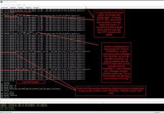

BUT if we close the RTT Viewer or disconnect, connect a few seconds later:
Log Viewer download the last chunk and then logging completely stops.  Firmware is still running because shell still works as can be seen below - I queried the uptime twice:
It's interesting it shows the # of messages dropped so that part is good, and it does download 1 last chunk of logs which look fresh, but then it fails to download newer ones!

    I do not see how those two settings could fix the problem, and I believe it is a bug that's causing this issue. Let me explain:
    Those settings are controlling the RTT retry while in an active connection with RTT, if you read the description.
    The problem in this case is RTT buffer is full, and we know that from "log mem" that I showed in the screenshot above.
    However upon opening an RTT connection, while the buffer is full, the RTT doesn't pull the data from the buffer!!!
    I suspect the RTT log backend is overwriting the data in the buffer, but somehow "the trigger to download (or upload to PC)" the buffer is not working.
    Also from a different view, if you're suggesting increasing those params help, (which I don't think they do), they will only help up to when their limits are reached, so for a system that has been working for days, months, years, and has been overwriting the logs in the RTT buffer, eventually the retry ms and retry count will be reached and the same problem will occur. i.e. when you go connect via RTT viewer to such system, if we're beyond those timeout * counts, then it has stopped trying (based on what you suggested) and it will stop logging. This isn't the expected behavior.
    The expected behavior is RTT buffer gets downloaded into the RTT viewer on connect (this always worked with previous versions, nRF SDK and nRF NCS) and this is failing in this example. Simply that is the root cause or the issue itself. If you don't believe this, when you have the issue reproduced, keep sending "log mem" and you will get Blocks Free: 0. no matter how long you wait.
    In fact it looks like it downloads the buffer, but then it something breaks the RTT process? perhaps need more stack? higher system work Q buffer? something on those lines?
