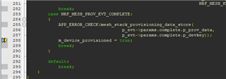

While debugging, I was able to figure out that the "m_device_provisioned" flag is set to "true" at this location:
However, after that, the GATT connection is closed, as evidenced by the call to the "a_link_close_notify" function, which informs subscribers about the NRF_MESH_PROV_LINK_CLOSE_REASON_ERROR error:

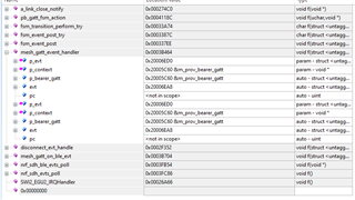

Call stack up to this function:
