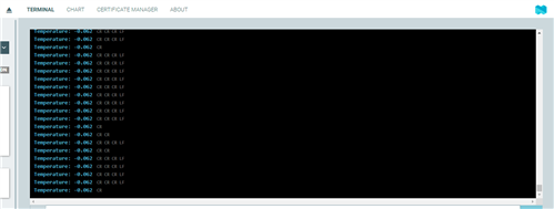

  • Update: I managed to get it printing values to the lte_modem. Ended up moving everything to the main.c folder, added the suggestion from this post and added in prj.conf::CONFIG_NEWLIB_LIBC=y and CONFIG_NEWLIB_LIBC_FLOAT_PRINTF=y. But now I am getting the same error as the original post that did this (I am getting the temperature as -0.062 every time.)
    Does anyone have any idea on how to fix this? I do not have access to a logic analyzer right now.

    My recommendation would be to connect the GPIO pin you would like to use to a LED on the nRF9160 DK first, as demonstrated in the Blinky sample. This way you can verify that the devicetree configuration of your application is correct. Afterwards, you can switch the pin direction and check if the sense mechanism works as expected.

    Since you would like to implement a sensor driver which not directly is integrated into the Zephyr RTOS, I recommend you to verify the dataflow on the configured pin with a logic analyser or oscilloscope.

    Thank you for the response. I apologize if the questions are repetitive. What exactly would I be looking for when examining the dataflow with the logic analyzer/Oscilloscope? I can get access to an oscilloscope so that might be mostly what I use. I am already aware that it is currently sending all the bits as 1 right now so what would be the next step in checking the data flow?
    I’m not familiar with the DS18B20 sensor myself, but if you look at the specification for the 1-wire bus (which you e.g. can do in this data sheet on page 10), you can find its requirements there.

    What you have to verify is that your driver layer sends data/bits according to this specification and that the nRF9160 GPIO sense mechanism is configured correctly in order to be able to receive data/bits.
