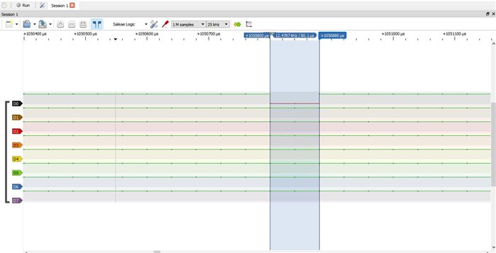

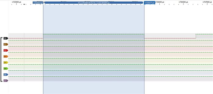

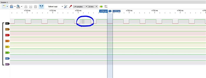

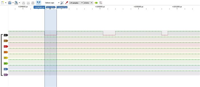

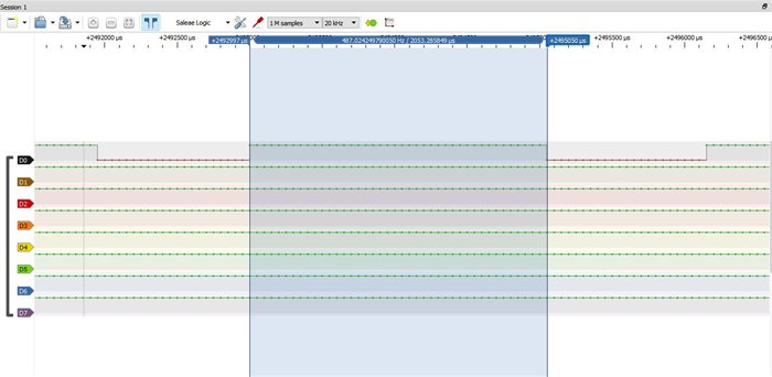

    I attempted to use the above function, but it is still not reading the values correctly, and the way it calculated the temperature is wrong. I managed to probe the data line with a logic analyzer and may have found the issue but I don't know how to fix it. So it looks like there is a delay when setting the pin to low/high from the state it was in before.

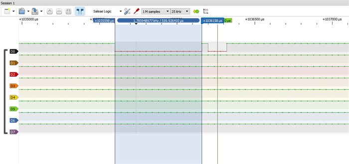

    I tried only running the SetResolution function and this screenshot is the reset function that is called in the beginning of setResolution function. It should only be low for 480 us but is low for 558 us.
    This delay is seen everywhere else, like this screenshot shows the first couple bits that are sent from the "sendbyte(SKIPROM)" command in SetResolution(). It is sending LSB first and should be sending 0,0,1,1,0,0,1,1. when sending 0's, it should only be low for 65us but it is low for 157 us (1st screenshot). And when sending high, it should be low for only 10 us but it is low for 80 us (2nd screenshot). This causes an issue because in order to Write 1 to the DS18B20 sensor, it needs to switch to the high state within 15 us after being low (setting it low is what initializes the timeslot).
    So now I know why it was sending me wrong values but I have no idea how to fix it. Can anyone please provide some guidance on what I can do to make the delays in my code execute more accurately without so much delay in switching between setting the pin High/Low?
    Is the issue that the clock is too slow? Or is there something else I should be doing?

  • Hello Nandini,
    Here are my suggestions:
    • Debug through the driver layer of your code and see if you can find something suspicious. For this, I recommend you to use nRF Connect for VS Code.
    • Use the blinky sample as reference and connect the probe to the pin controlling the LED. Do you see the same delay there?
    Markus

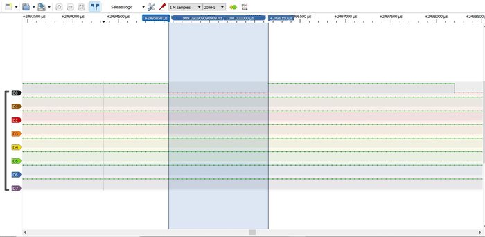

  • Hi
    I tried running the blinky code that access info directly from the devicetree while placing a 2000us delay after setting on and a 1000 us delay after setting it off. When doing the delay in ms, there is not much delay, but when doing in us, there is a delay of 50 us when going high, and 100 us when going low.
    I also noticed that the delay increases when I increase the clock speed to 25 kHz. Do you know why that is? And I also noticed that it briefly goes low when its high sometimes. (3rd screenshot below) Does anyone know why that is too?
    I also didn't notice anything weird when I debugged through the code.
    I am approaching my deadline for my project really soon so any help would be really appreciated. Thank you!
  • Hello Nandini,
    Are you using k_usleep() for this? As documented, you should use the function with caution and probably adjust CONFIG_SYS_CLOCK_TICKS_PER_SEC as well.
    The default low frequency clock should be 32 kHz. Which value did you increase it from?

    Have you tried to define a timer that indicates a toggle of the GPIO pin in its handler?
    Markus
    I tried your suggestions. Changing the CONFIG_SYS_CLOCK_TICKS_PER_SEC did reduce the delay, but the code would not run when I left debug mode. And since I needed this project to be portable, I couldn't use that.
    The timer suggestion works if you want to repeat something over the same interval, but my issue had a lot of delays and kind of made it difficult to incorporate this.
    What ended up working for me was replacing all the k_usleep()/k_sleep with k_busy_wait(). Its able to get down to 3 us accurately (when I do k_busy_wait(1), so there is a 2us delay) and that was enough for me to incorporate the ds18b20 sensor. If you need a 1us delay, I found not putting any delay seems to do the trick, though it might be a little inconsistent.
    So it works now! thank you so much for all the help and helping me narrow down the issue. I really appreciate it.
