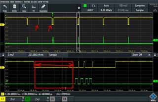

I'm using the PA LNA driver for the nRF21540 with the function:
void mesh_lna_setup_start(uint32_t rampup_start_capture_time, uint32_t timer_index)
Now, when I check the TX and RX signals, I can see that the RX enable PIN is switched low every 200ms, not only during the TX interval.
How can I change this to 100% receiving time? When a packet is coming over BLE and the RX is switched off, this packet is getting lost.
Here is the plot of the TX, RX enable Pins:
CH1 is TX, CH2 (green) is RX:

  • What is the reason for this RX low every 200ms? Is it a sleep mode? This should not happen, I need RX on high-level all the time wehn TX is low.
    I noticed you are using default configuration, this enables the GATT feature which means GATT bearer is enabled in softdevice.  To make PA\LNA work with GATT the feature should be configured separately.
    You should follow documentation here.
    Can you clarify whether you keep GATT enabled and configured PA\LNA correctly for it? Have you followed the documentation?

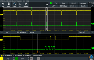

  • Here are the results:
    CH1 (yellow) = RX enable
    CH2 (green) = TX enable
    What I don't understand is why RX goes low without TX is sending something, can you explain this?
