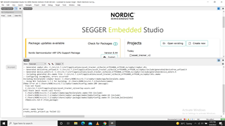

Hi, I downloaded a project from Git. I tried to open in SES using nRF Connect SDK. During the initial Cmake, the error occurs as shown in attached image.

Ok, I've talked to the developer of the application and I'd like to take a step back and figure some things out.
Downloading that github repo is not how we recommend users access the asset_tracker project. Instead we recommend following the steps in the documentation: https://nordicsemiconductor.github.io/asset-tracker-cloud-docs/v1.8.x/docs/firmware/azure/Index.html
There is a version of the asset tracker at nrf/applications/asset_tracker_v2 which works out of the box with v1.9.1. You can add the Extra CMake Build Options when opening that project to build it for azure. Is that what you are looking for?
Is there is a specific feature in the updated repo that you need, which you can not find in the v1.9.1 version?

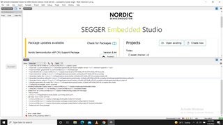

Thanks for your reply. I tried open deafut Asset_tracker_v2 provided by Nordic, by adding both of suggested overlay configurations thorugh Extra Settings one by one, but project does not got created and the error appears as shown in images:
Earlier you were using v1.9.1, but in this image you seem to be using v1.7.1.
Do you get errors in v1.9.1 also?
Yes, I tested in 1.9.1 also. Error appears, but the line number changes.
In 1.7.1 the error is .... /cmake/Kconfig.cmake: 209
in 1.9.1 /cmake/Kconfig.cmake: 213
in both case project is not created and opened.
