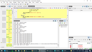

    while debugging i got this after few second
    info> app: defualt break2
    <info> app: data_array2:
    K,0.00,0,0,110
    <info> app: opt1:0
    <info> app: defualt break2
    K,0.00,0,0,110
    <info> app: opt1:0
    K,0.00,0,0,110
    <info> app: data_array2:OK,0.00,0,0,110
    <info> app: iam in app uart cmn err
    <error> app: ERROR 1 [NRF_ERROR_SVC_HANDLER_MISSING] at C:\A\DeviceDownload\nRF5SDK1702d674dde\nRF5_SDK_17.0.2_d674dde\examples\
    <error> app: End of error report
    for more information i copy the error also .
    here data_array2 is the data from the sensor board and which is connected to the UART P1.3(TX), UART P1.4(RX) pins of the MCU and at this time BLE is connected to my MCU device but when i am trying to send the data from the customized APP its working for few second and its stopped by displaying the above error and BLE gets disconnected after this.

  • Hi
    Are you able to see what function or base number that is returning the NRF_ERROR_SVC_HANDLER_MISSING error, as this should give us an idea of what exactly is going wrong.
    Does your application enable the SoftDevice, and do you also flash the SoftDevice onto your device? What SoftDevice version are you using? Here you can read more on the SoftDevice and Supervisor Calls (SVC). You can get this error if you have not enabled the SoftDevice (using sd_ble_enable) or if the headers included for the SoftDevice are not the correct headers for the particular SoftDevice you are using.
