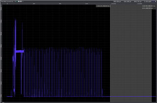

I'm working on getting PSM mode with the Serial LTE Modem on the nRF9160 v1.0.0. The power consumption of the modem (26.4 uA) is too high compared to the documentation in PSM (it should be 2.7 uA).
I juste used the file "nrf9160dk_serial_lte_modem_2022-02-17_ec486dab.hex" and "mfw_nrf9160_1.3.1.zip".
I send this commands :
AT+CPSMS=1,,,"10100011","00100001"
at#xsleep=2
I work with OTII :
I don't understand why the consumption is so high.
Also, I don't understand how to wake up the modem once it is in PSM. When I send commands via the UART after the command "at#xsleep=2", it does not respond.
